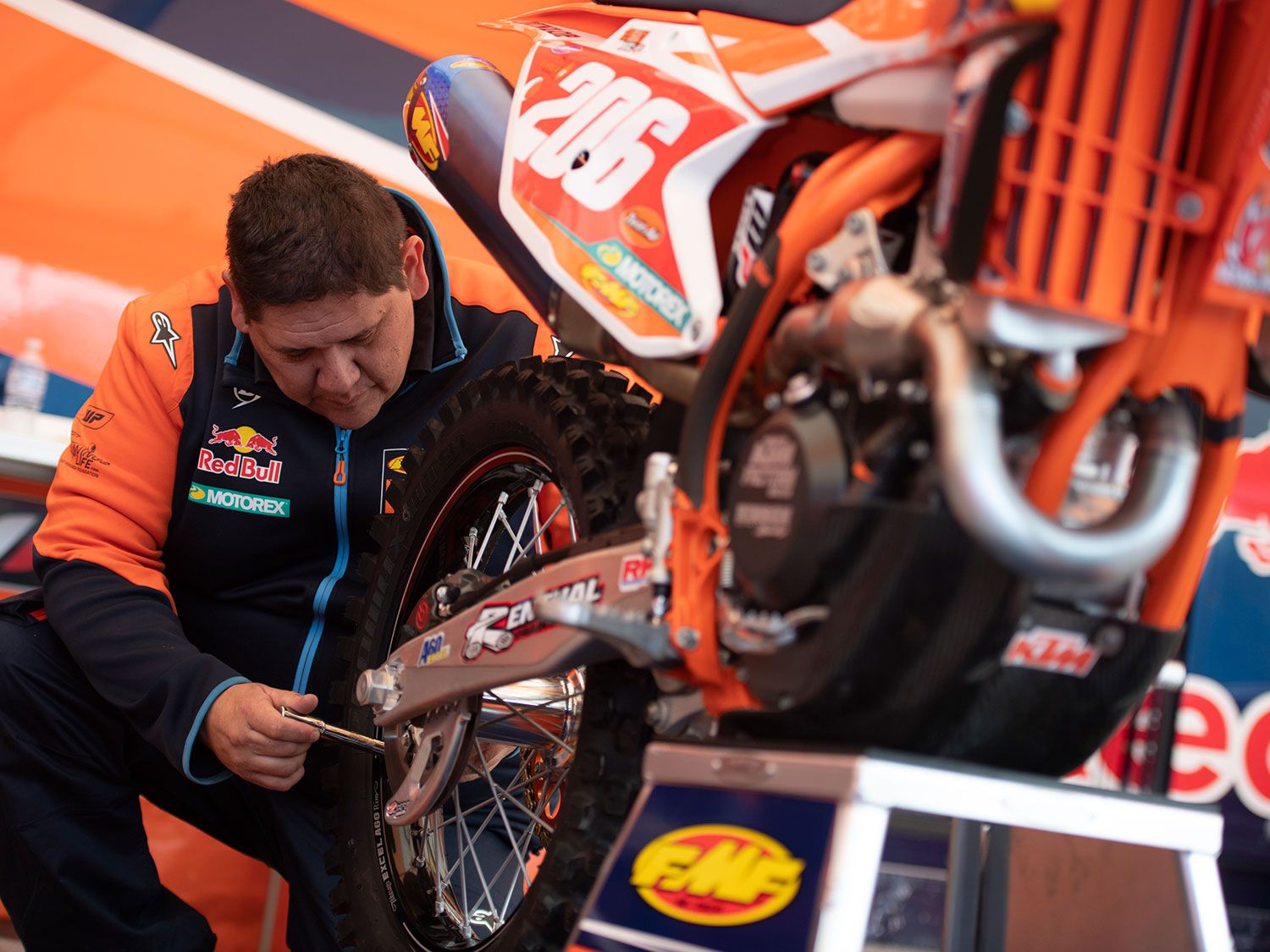

Jose Cordova double-checks the suspension linkage on Ben Kelley’s bike.
Jose Cordova double-checks the suspension linkage on Ben Kelley’s bike. (Shan Moore/)

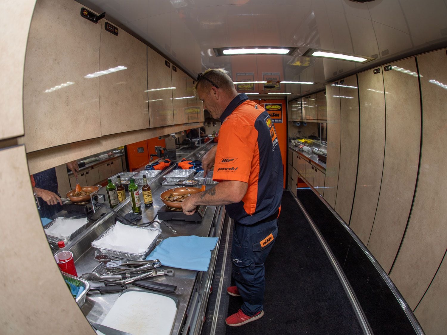

Brian “Rabbit” Sweet prepares a meal on Saturday for the team.
Brian “Rabbit” Sweet prepares a meal on Saturday for the team. (Shan Moore/)
Marchant added that each rider has a complete spare engine sitting in the rig just in case it is needed.
“When it’s time to swap an engine, the one we pull out ships back to KTM in California on Monday, so usually that’s the job for the truck driver, Brian ‘Rabbit’ Sweet,” Marchant said. “He’ll drop them off at UPS and they get shipped back to California. Then crew chief and engine man Tony Hall will go through those engines and ship them back to us before the next GNCC.”

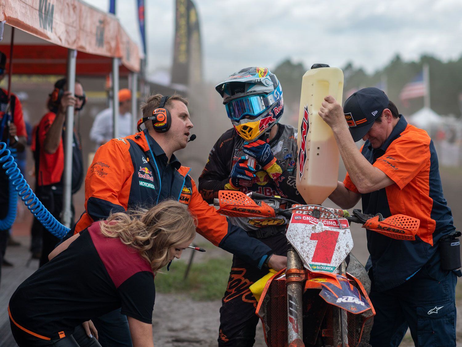

Crew chief Tony Hall talks to Russell during a gas stop while Mitcheff refuels the bike. Russell’s wife, Chandler, is there to provide new goggles.
Crew chief Tony Hall talks to Russell during a gas stop while Mitcheff refuels the bike. Russell’s wife, Chandler, is there to provide new goggles. (Shan Moore/)
Once the race begins, the mechanics each have specific roles at a GNCC.
“So that’s going to kind of vary on the course,” Marchant elaborated. “Typically, though, we’re all three going to be chasing our individual rider during the race. We all have headsets on so we can still communicate with each other. When team manager Antti Kallonen is at the races, he’ll float. He just kind of floats around to see where the riders might be taking a bad line, just kind of helping out a little bit there, but he’s mostly at the semi truck. When a rider comes in for fueling, we’re all going to handle our own individual rider. Then typically that’s where Rabbit comes in. He’s at the semi the whole time and he’s going to jump in and help out with miscellaneous help, whether we need to pressure wash radiators or put the fuel cap back on, hand the rider a drink bottle, or something like that.”
